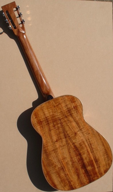

I've used (and still have some) California black acacia, acacia melanoxylon, which is the same as Tasmanian blackwood as far as the Latin is concerned.   I find it to be denser than acacia koa...more like Indian rosewood in that sense. It's great guitar making wood, at least for backs and sides. Yes on the interlocking grain, but I've got a wide belt sander so it just isn't an issue. But that interlocking quality should make it very tough and crack resistant. Might be good for a bar fight guitar...

I've used it and its great to work with....better than Koa IMO.

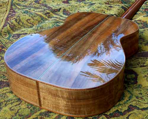

Beautiful Hesh!  I expected to see some black lines running through it.

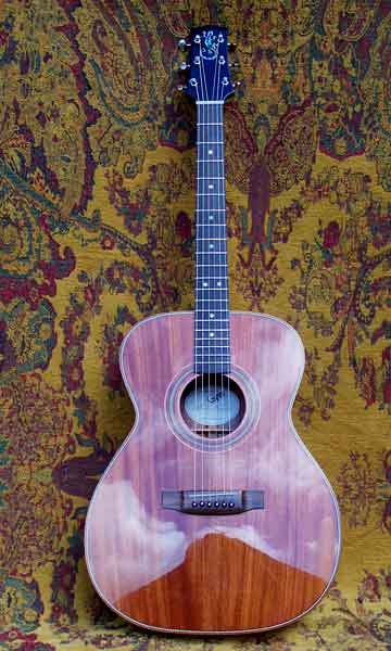

I used Tassy Blackwood on my second guitar. It's so easy to bend, but I found it dulls tools and sandpaper quickly. Also my hands seemed to take on a black stain every time I worked with it. Perhaps why it gets it's name?
Fiddleback acacia bindings and end graft.
I matched it up with a Australian Cedar top that I thought really complimented it.
Allen R. McFarlen

PostPosted: Sun Sep 16, 2007 7:34 pm
Posts: 1055
Nice top Allen. What species is the Aussie Cedar and where did you get same?

[QUOTE=kiwigeo]Nice top Allen. What species is the Aussie Cedar and where did you get same?
Cheers Martin[/QUOTE]
I got all the wood for this guitar from Berry Kerr. It's suppose to be Queensland Cedar, but I don't know if there is a any difference to Australian Cedar. I suspect its still Toonis Australis, just sourced from Queensland.  I've been trying to get some more, but seems hard to come by in quality sizes for tops.
